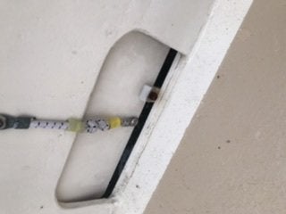

I need some help. I know someone here might be able to steer me in the right direction. I have a 42ft Maineway(H&H) inspected vessel with large scupper holes that are mandatory by the coast guard. I’m looking for a custom scuppers that I can install on the outside that will keep the deck on the dry side for the most part. I had stainless inserts on the inside but the CG made me remove them last season. Was thinking of getting customs ones made like the two bottom pictures. Any suggestions would be greatly appreciated.

I made very similar scupper covers for the last certified boat I had. Same problem you have now, those big freeing ports allowed water in as much as they allowed it out. CG wont allow a deck port plug from the insdie but a one way flapper like you are looking at never really got a second look. If you have any doubts contact your MSO and run it past them before you do all the work.
The deck ports on your boat look pretty big so you will have to make your own as I did. I used something like starboard for the flappers and frame and some SS rod for the hinge part and just like the pic some light bungee to help hold it shut. They do need to be fairly robust or the waves will break them off. Depends upon your inspectors if they give you and grief about it or not, one just made sure they flopped open easy, others never even glanced at them.

This is what I had, They werent perfect but helped but the CG made me take them out, I had them removed for the inspection but they saw the brackets.
